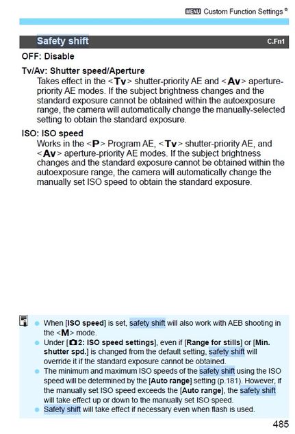

As Demetrius mentioned, check if safety shift is turned on in the custom functions. This will override your settings if needed to cause a correct exposure if not disabled.

Thanks a lot ! That answers the minimum speed overide indeed
