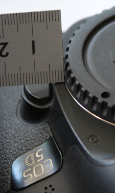

Testing I am able to reproduce the problem repeatedly, and provide some insight to why I think this happens on the 5D Mark 3
Original situation when the issue happened to me
5D Mark 3 using a 24-70mm lens shooting down towards the ground
The 24-70mm lens is an important factor as the focus ring on this lens is next to the camera body, which puts the focusing hand close to the lens release button
Test Picture 1
With the 5D Mark 3 facing down and resting on both hands as shown, the lens release button will depress under the weight of the camera body on the left hand. (feels like the camera body does not feel like a button)
This is unique to the Mark 3, the button wont depress on the original 5D or the 5D mark2 while holding the camera the same way and using the same 24-70mm lens
Test Pictures 2 - 5
This happens on the 5D Mark 3 only because
The button sticks out from the lens by 4mm more on the Mark 3, This means the focus hand has full and unrestricted access to the button
On the 5d the focus hand is not directly above the button but on the Mark 3 it is directly above
2016-12-31_12-14-41.jpg5D Mark1
2016-12-31_12-17-09.jpg5D Mark3 button sticks out 4mm more and is exposed
The button on the 5D and the mark 2 are partially recessed into the camera body, this does seem to provide some protection from accidentally depressing by hand while focusing
2016-12-31_12-20-05.jpg5D Mark 1 button recessed
2016-12-31_12-20-53.jpg5D Mark 3 button not recessed and exposed
The button is also 1mm bigger on the 5D Mark 3 and as said earlier sticks out from the lens more by 4mm
2016-12-31_12-21-31.jpg5D Mark 1
2016-12-31_12-21-13.jpg5D Mark3
Summary
The button on earlier models does not stick out enough for the hand to rest directly on the lens release button
Earlier models also have the button partially recessed into the camera body providing a degree of protection
Many people are losing lenses because of this

"I would ask another question.  Is this lens specific or does it happen with any lens?"
Thanx, you have answered my question and I see how that is possible. It seems as it is one of those if the Sun and Moon and stars have to be aligned in a certain way, it can happen.  Even your example requires the lens to be zoomed in just one direction?
But now the question is, you know that can happen so why are you or folks causing that specific situation to occur?  The answer seems simple.  Don't do that.
I am truly sorry if you have lost a fine lens that way.  I know that crunch when a lens hits the ground.  Not a forgettable sound!
