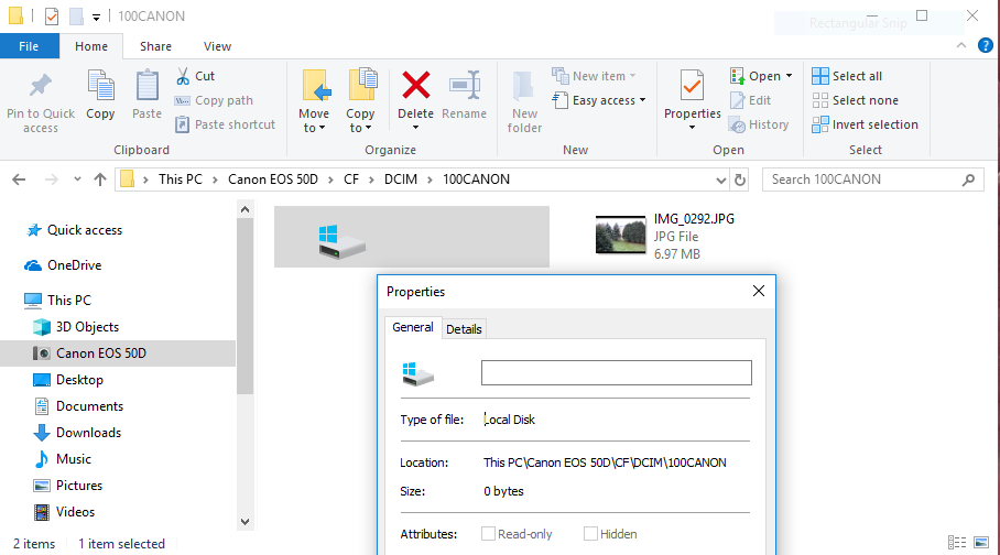

To clarify this situation further, it is indeed a Windows 10 and 50D issue. If you had a 50D with a UDMA 7 card containing CR2 files on it they would not be recognized by Windows 10 via a USB connection, in that they would be seen as zero byte files which can not be moved or copied (see screenshot for what should be IMG_0292.CR2). That Windows 7 does not exhibit this incompatibility indicates an introduced issue with Windows 10 (and maybe 8/8.1, I don't know).
This card/interface incompatibility should not be construed to reflect possible issues with other Canon models (ebiggs1), or card readers (Bob), as putting that UDMA card into a card reader presents no problems whatsoever. As I stated earlier "Definitely some incompatibilities here,", and that is indeed the issue being addressed. One wouldn't expect the requirement to use a card reader to read CR2 files, but that is the current scenario, as even EOS Utililty run in Windows 7 compatibility mode hangs and then does not transfer all the files on the card (it is hit-and-miss with both CR2 and JPG files).
In summary, with this model and Windows 10, CR2 files on a UDMA 7 card must be read from a card reader. Non-UDMA cards containing CR2 files present no USB transfer issues. It is indeed a peculiar issue, and I would not expect others who have not experienced it to understand that this problem could actually occur.

I do have a 50D, so I tried some experiments the other night, using a 32GB Lexar Professional UDMA 7 CF card and an up-to-date installation of Windows 10 Professional. I wasn't able to reproduce your problem exactly, but I did have problems. For example, the camera would transmit one or two files (correctly), but then get stuck in "BUSY" mode. (I quit trying when I finally started having trouble clearing the BUSY.)
Upon reflection, I guess we shouldn't be surprised. The types and sizes of CF cards we use now didn't exist when the 50D was current, and many camera models have had trouble adapting to larger cards and more complex file systems.
