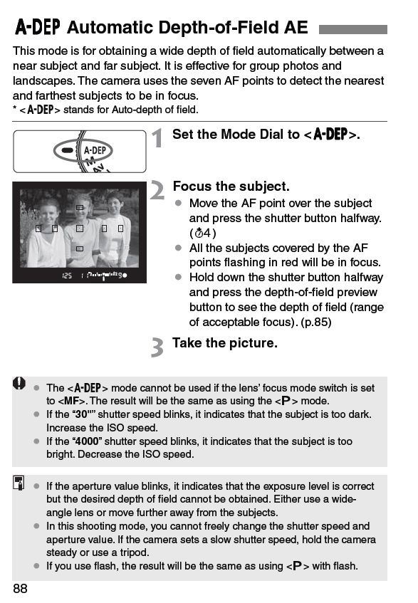

There used to be a mode called A-DEP on the early digital cameras:
But it is long gone, too.
I am guessing that with the huge number of focus points on later cameras, it just wasn't feasible to have this feature, and few used it anyway.

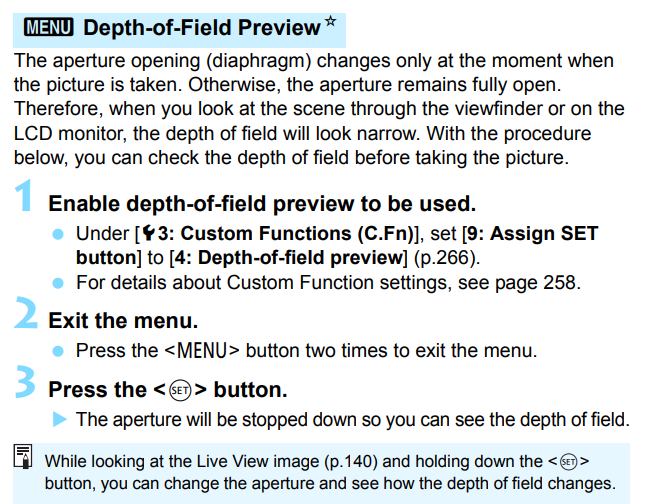

11-12-2024 10:03 AM
11-12-2024 10:09 AM
We are not talking about DOF preview.
The DEP and A-DEP modes actually used the difference in distance between two (or more!) focus points and adjusted aperture and shutter to get those focus points in focus.
I have often felt it would be nice to have a hyper-focus setting on a digital camera.

Just for the record, here is how the DEP mode on the A2 worked:
