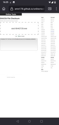

I have all EOS firmware updates that Canon has published. The sha256 checksum for 1D II is ff4949eb1f3f1776f32a110101bfb9d9bc823c461afa72344d64decee98d694c eos1dmk2126.exe
That means you can download from anywhere as long as the checksum is correct. There are online tools to check a files' sha256 checksum.
I downloaded the file from the link the user 5DIV posted and I got the same sha256 checksum as from the one I have on my computer.

Thanks for checking it out. So Jasonv2142 can download and use this firmware file.
