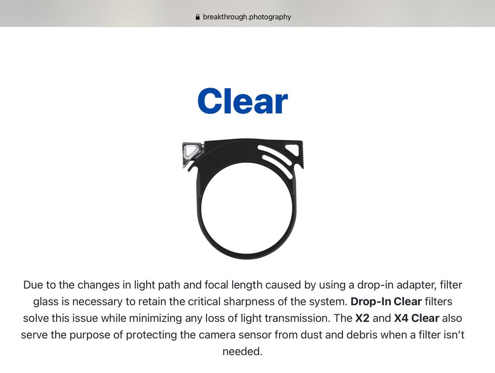

There is supposed be an optical element in the drop in filter to maintain optical integrity.
There is a San Francisco company called "Breakthrough Photography" that makes compatible drop-in filters for the Canon EF to EOS R adapter. In addition to various CPL and VND filters, they have clear filters starting at $69.

Canon also sells a clear drop in filter for $140.
