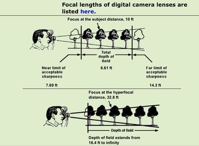

I agree with John’s reasoning. You said rhat you focus one third of the way into the field of view. That’s good advice. This chart and illustration help to explain why one would do that.
