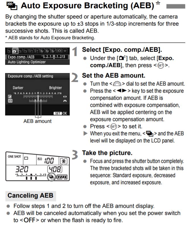

OK..You have inadvertently activated the AEB - automatic exposure bracketing mode.  To cancel it, press the Q button, navigate to the exposure compensation - see the 3 bars? Rotate the vertical wheel next to the shutter button until the 3 bars become 1.  The 2"5 just tells you at  it takes 2.5 seconds exposure, I believe.
Here is the manual on how to do it (set or cancel AEB)
Bless you, Diverhank! Fabulous. I was photographing a black bear when I screwed up the camera. Fumble fingers. :))
