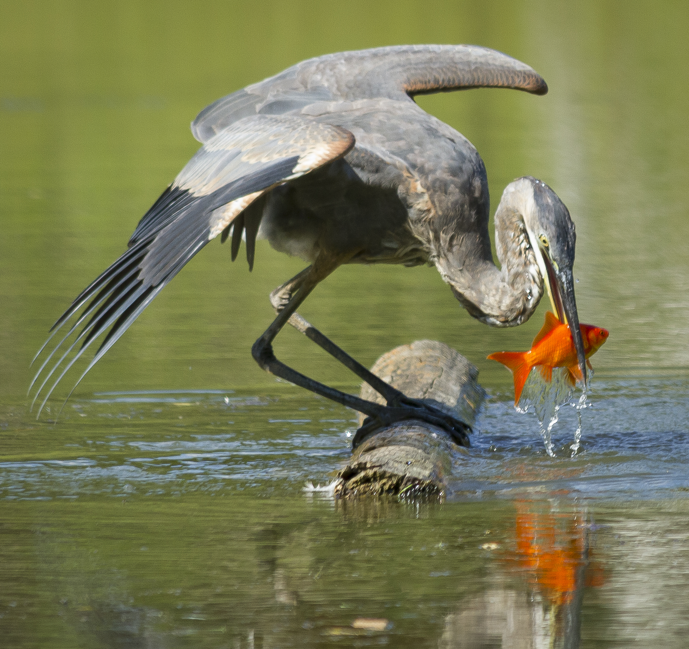

My wife has been using her Rebel T7i and Canon 70-300 IS USM lens. Over the last couple days she's been very disappointed to see that her images have a strange Double-blur diagonal lines effect in the background. And nowhere in the image is razor sharp.
See attached. A closeup of the bouble line bachground image is inset. (Autofocus, 300mm, 1/320th, f/6.3, ISO400 if that helps)
I have not been able to duplicate the problem but would like to help her prevent it in the future. She lost several hours on a beatiful day today and I like to help keep her interested.
Anyone seen this before? I'm not even sure where to start.
Thanks in advance for any thoughts.
joe

Here is what I eventually found for anyone looking at this n the future.
The UV filter was not a "Cheap" one, but I bought a new one anyway because it seemed logical.
When I went to replace it I noticed that the old one had some sort of film on the INSIDE of it I couldn't see from the outside. My GUESS is that this was causing reflections between the lens and filter. I cleaned the inside and haven't seen the distortion since. See attached.
I've always said that what is wrong with my photography can't be fixed by buying better equipement. This wasn't what I meant, but it fits this situation.
Thank you all for the help.
The type of aberration I suggested won't show in a photo like the heron.  It is possible that the filter was at fault. Let's hope so and not your lens.
