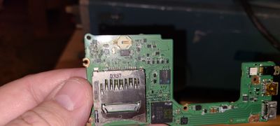

20220206_001903.jpgThis tiny battery is located on the SL1 main board just above the SD card slot. I believe only a Canon service center or a camera repair shop can replace it. My SL1 was bought when they were introduced. Never had an issue. I only know about this battery as I was given a sand and water damaged SL1 to check out and the board was fried. So I have disassembled an SL1 to the last screw.
