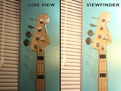

I'm having the same problem with my T4i.  The exact same shot comes out different depending which view mode you're in when shooting.  In RAW mode, the downloaded files are safe, yet on the camera screen it still previews images shot with the viewfinder as overexposed.
Updating the firmware didn't help the issue.
It's not a terrible inconvenience to have to shoot in RAW, or in JPEG mode using the live-view screen only.  But it's frustrating not knowing what the issue is, and would be nice to use the camera to it's full functionality.  Definitely seems like a malfunction.  Here's a quick example where the settings and lighting are exactly the same, just switching the view mode before snapping.  These were in Sports mode, using the EF 40mm f/2.8 STM lens, iso 6400.

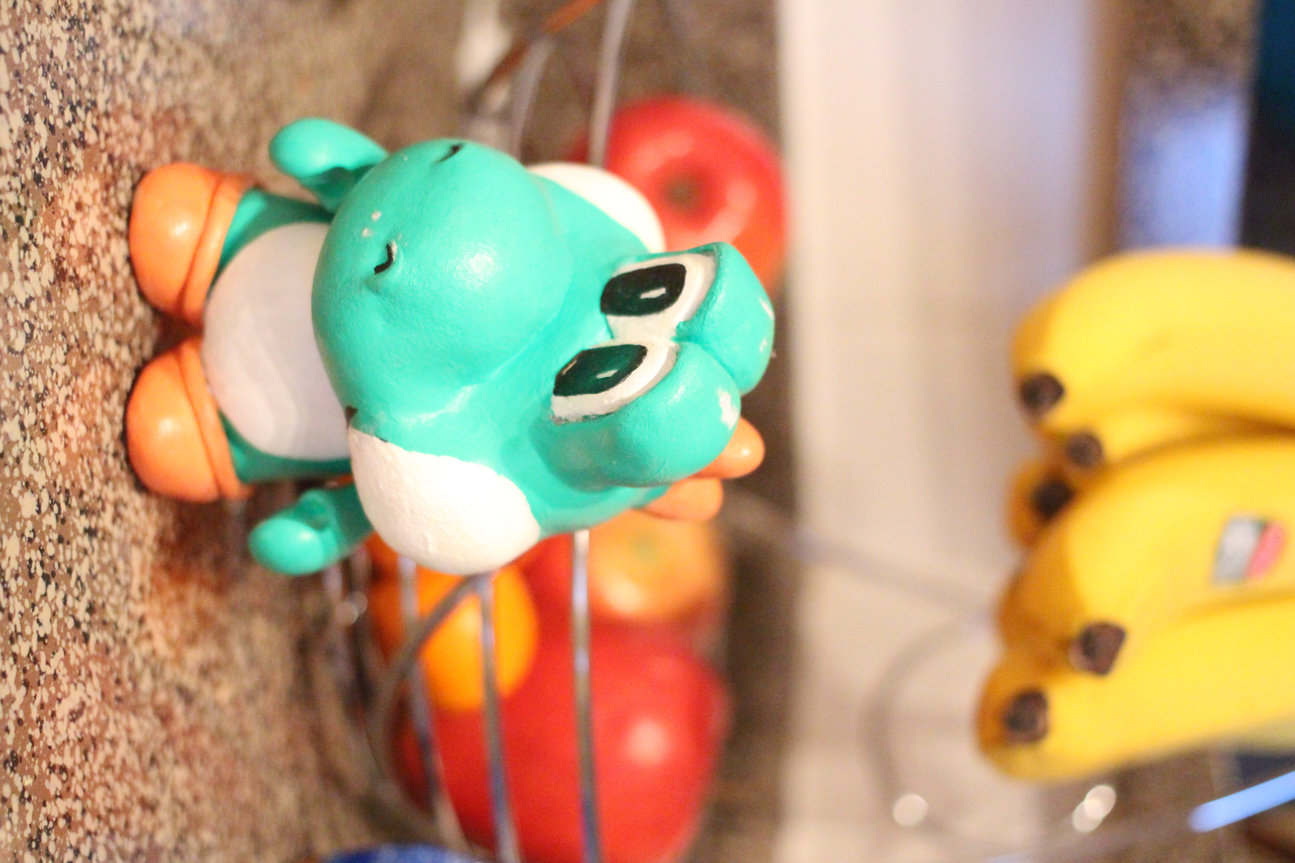

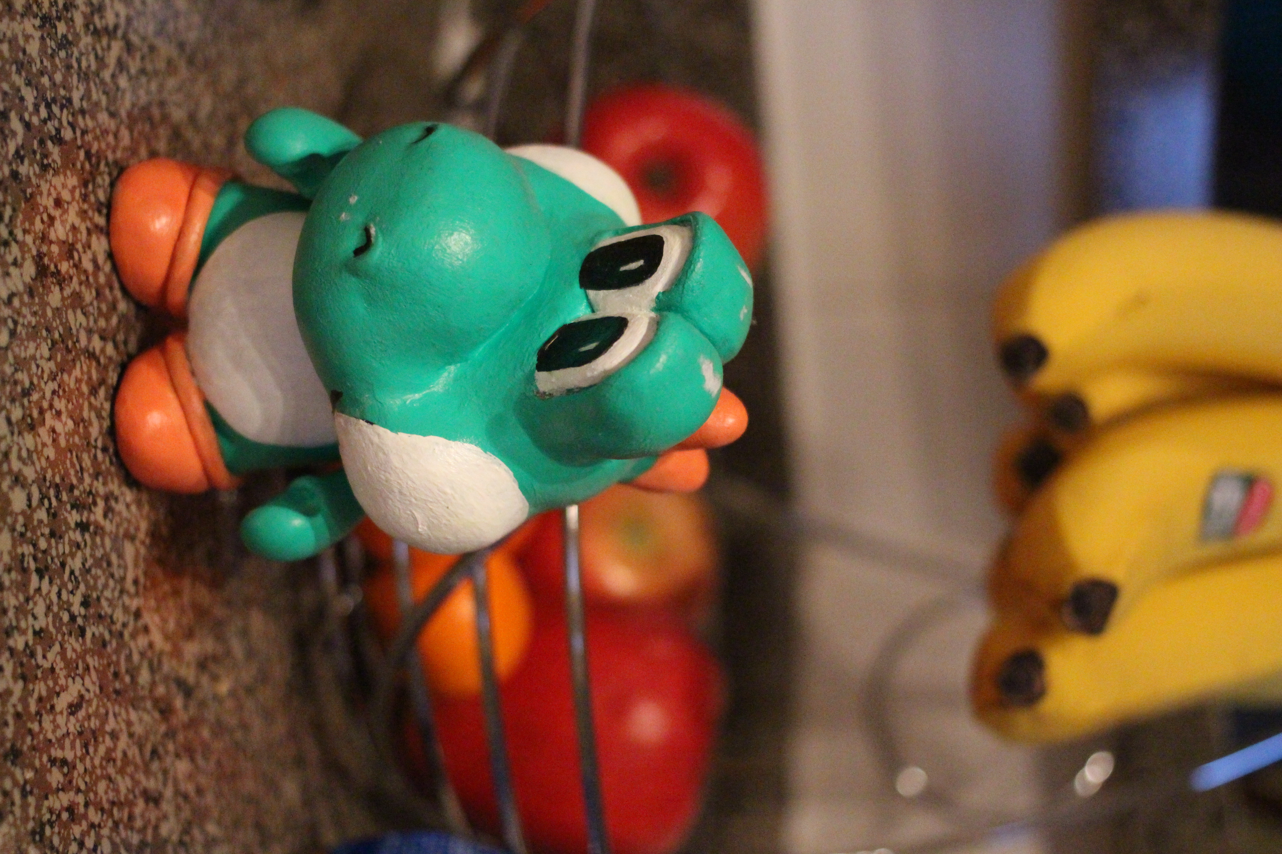

Thanks very much Tim, no problem.  Here's a new pair using the same settings. (This links to the files, in case there's an issue with the embeded shots below... Dropbox - Canon Examples )
Looking at the image EXIF data I do notice a few things... the settings are not actually identical save for the viewfinder vs. liveview mode.
Here's the viewfinder shot data:

 And here's the liveview shot data:

First, I do see that both shots used "Evaluative" metering.  I had suspected one mode might be using a different metering option than the other, but that does not seem to be the case here.  They should have come up with the same exposure so long as lighting conditions weren't actually changing between shots.  But note that the metering system in viewfinder mode vs. the metering system in liveview mode aren't technically the same.  In viewfinder mode the reflex mirror is down the shuter is closed and the mirror bounces light into the mtering system.  In liveview mode the reflex mirror is up so light can't get bounced into those same sensors and instead the camera has to use the image sensor to meter.
I am surprised they would meter differently and perhaps this is an indication that something isn't working as intended.
The reason one shot looks darker than the other is because they did not actually use the same exposure.  The viewfinder shot was taken at 1/100th sec.  The liveview shot was taken at 1/320th.
