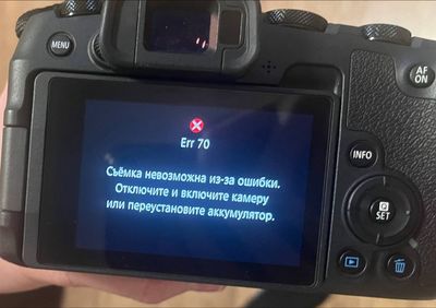

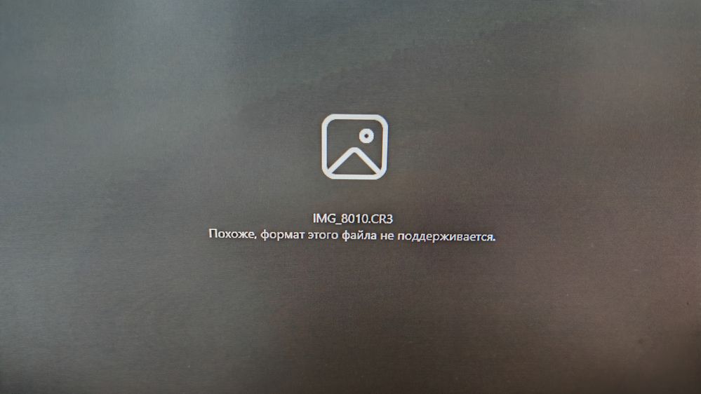

Canon EOS RP camera gives err70 error, canon rf 24-105mm F4 7.1 STM lens, this happened after shooting in burst mode without using any additional equipment. After that, all photos on the memory card were damaged.Canon EOS RP camera gives err70 error, canon rf 24-105mm F4 7.1 STM lens, this happened after shooting in burst mode using Godox Xpro-C sync and Godox v1c flash. After that, all photos on the memory card were damaged.

What do you mean by “damaged” pictures. The pictures were corrupted? Please show us a picture of what they look like. Godox gear is known to cause error 70 on Canon cameras. Try taking pictures without the Godox gear attached and see what happens. What were the lighting conditions like when this happened. What were you taking a picture of. Was the lighting not enough for the camera to lock focus.

Will the camera take pictures now? What happens if you try a different SD Card. Are you using a Full Sized SD Card or a Micro in an adapter. If so stop using in it. Those cause so many problems. What brand and capacity is the SD Card.

The camera takes pictures, after viewing the pictures, after a while they break down and cease to be available for viewing. I use a micro Samsung 128 gb card through an adapter

Tell me, please, is it possible to somehow restore these broken pictures?

There’s your problem the Micro SD Card in an adapter. Retest with a 32GB Full sized SD Card. When does Error 70 pop up? There are softwares out there to restore corrupted memory cards. But I don’t have any experience with them.
