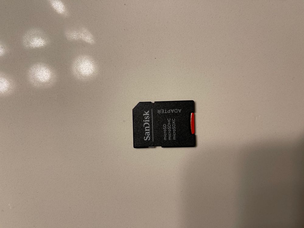

I attached a picture of the SD card. It is a micro-SD with an adapter. As for the shutter speed it pretty much stays the same. This microsd is a SDXC UHS-I which is 120GB and speeds up to 120MB/s.
01-13-2022 01:50 AM
and that is 120mb/s read speed

Micro SD cards with adapters are not encouraged for Canon cameras because the adapters often give problems. To eliminate the card from the issue, do you have a full-size SD card available you can try to use instead?

The issue might be the exact opposite of my first thought - you are using a 9 year-old camera with a very fast card. Generally Canon cameras do not work well with MicroSD cards and adapters to begin with, and that might be exacerbated by using a far faster card than it was originally designed for. To try to eliminate the card, do you have a full-size SD card you can substitute for the one you are using?
