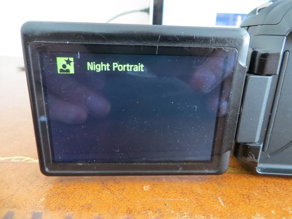

The rotating display screen works as normal in upright position. However, when I rotate it, only the top part (approx 1/8) of the display lights up and displays the top part of image or controls. Rotating the display back to original position restores a full display. I have tried re-seating all connectors, replacing the display pcb (on back of display), replacing cable (as problem seems to happen when screen flicks over). I even attempting replacing the entire back with a back and display from a 600D and problem moved to new 600D which implies that problem is with the back (not the controller in camera). I am at a loss and apart from trying to replace display (dubious it could be that as it works when display is rotated) i have no idea as to where the problem is. Any ideas and has anyone seen this before?
05-12-2024 02:18 AM
here are a couple of images of problem I have described ...Screen upright - all of screen visible
Screen rotated - only top visible
