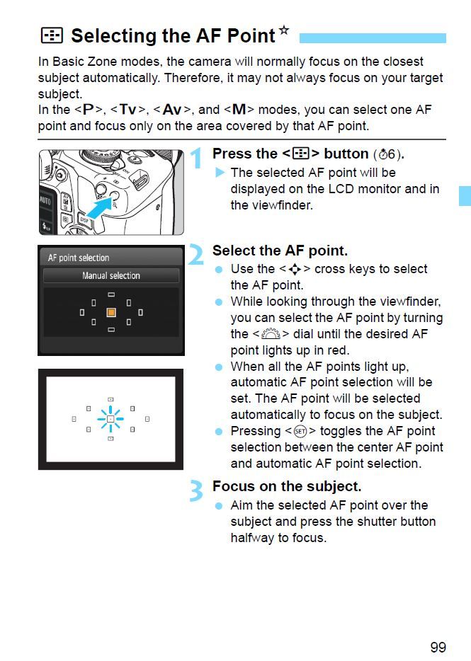

Okay great thank you! How do you select all focus points in the T7?
Thank you!! I really appreciate this
Take a look at page 99 of the manual.  When you press the appropriate button -
the focus points will be shown on the back display and in the viewfinder.  turning the main dial cycles through the focus points.
https://gdlp01.c-wss.com/gds/0/0300029810/01/eos-rebelt7-1500d-im-en.pdf:
Check out the User Guide: eos-rebelt7-1500d-im-en.pdf (c-wss.com)
To select an autofocus point see P99 - recommend a Single Centre Focus Point.
Metering modes: P115 - recommend setting to Partial Metering
Locking the exposure point. P120
