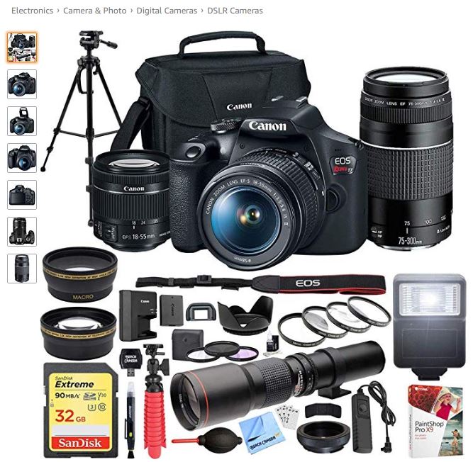

Canon EOS Rebel T7 DSLR Camera with EF 18-55mm with EF 75-300mm Double Zoom Kit Bundle with 500mm Preset Telephoto Lens, 32GB Memory Card, Tripod, Paintshop Pro 2018 and Accessories (10 Items)
This is what I bought everything that's in there I bought it came with
[Link removed per forum guidelines. Replaced with screenshots of what was found at the link's destination]

Oh, one of those. That type of lens is very good at teaching you how to use a tripod. I had the 650-1300mm version. I bought an eyepiece for it, so that kids could use it like a telescope to look at the Moon. That bit of excitement wore out pretty quickly.
Those lenses require a very stable tripod, and a T-Mount adapter. The tripod foot tends to have a little slack and play in it. It may wobble just enough when you are focusing that the Moon may move around the frame. It will look like an earthquake is in progress.
The "Preset" part of the name means that the aperture is fixed, probably at f/8, and cannot be adjusted. This is fine for taking shots of the Moon. Use manual mode, set your shutter at 1/200 and ISO at 100. Use the 10-second shutter delay time. If that camera model has shutter lockup, then use that, too. Use those exposure settings no matter what phase the Moon is in.
I wound up with some images of the full Moon that were not half bad. It was hard to focus because the focus ring's "throw" was only 1/4 of a full rotation. If the focus ring had 1/2 to 3/4 rotation, the lens would be MUCH easier to focus. The only saving grace is the narrow aperture creates a deeper depth of field, so focus does not need to nailed spot on. Practice focusing on really distant objects during daylight, and place some tape on the focus ring.
Your biggest enemy will be time. The Earth and the Moon are both in motion. Once you get the Moon centered in the frame, it can move completely out of the frame within a minute or two. Now you have to readjust tripod, which I hope has a VERY good head on it.
Many tripod heads suffer from what is known as "backlash". This means that the position of the head may shift ever so slightly as you fully tighten it down. This is not much of an issue with smaller, lighter cameras and lenses when you are aiming horizontally, which means the center of the weight is over the center of the head and tripod.
When you tilt the camera and lens toward the sky, suddenly the weight is off-center and backlash can become more pronounced. The heavier the load, the worse the backlash becomes. If you are using a ball head, you want one with a friction adjustment because this can help minimize backlash, and those that have it tend to be better built, too.
