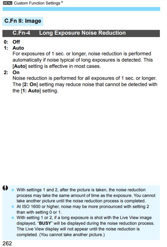

@mdutoit wrote:I took the camera outside today, and it allows me to take pictures in the 'green square' mode but when I take it inside I get the busy signal again. Rather confusing.
It is most likely that you have the Long Exposure Noise Reduction option turned on. Try turning that off. As much as I like Canon cameras options, I think this option is one of the more useless ones. It will bring your camera to its knee for minutes at a time while offering questionable noise reduction.
