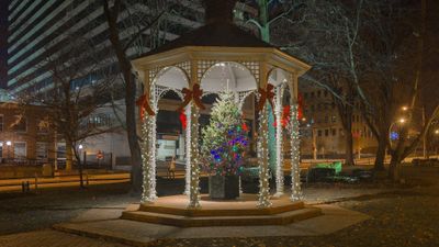

[EDIT] This is an HDR imag from 5 shots.  Notice how half the tree seems unlit.
