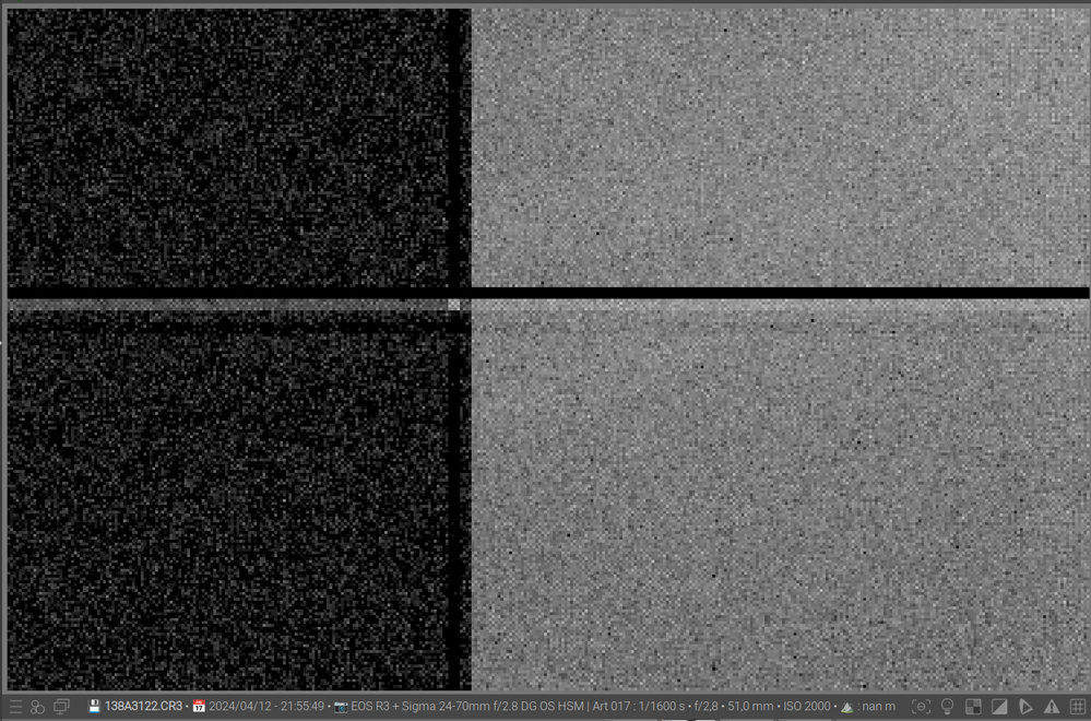

  • So last night during a show my viewfinder started flashing horizontal lines across the screen. Occasionally these lines would end up on the photos. Not all photos I would take were affected but I feel like somehow the sensor has been damaged. It isn't the SD card as it does this when no SD card is in the camera. Not the battery, either. I've also done a factory reset and still the same. Any thoughts on an estimate to have this fixed? The camera is a year and a half old and the shutter count has to be upwards of about 250,000. Thanks! Screenshot_20240413_123356_Gallery.jpg

All three below if you bring up shadows you'll see the banding horizontally. This is what is showing in my manual and LCD viewfinder. This just started last night in the middle of the show. Definitely a sensor issue. Just have to find out how severe and if I can repair this via Canon.

Never seen that before. It is not laser damage because it moves around.

There is also a vertical line in the masked pixels with no signal at all. I don't think R3 should have that.
I had an issue about a year ago with these lines showing up on photos but I think it was a bad CFExpress card. Swapped the card out and hadn't had any issues until last night. These lines appear on the digital and manual viewfinder even if there's no card in the camera. I've placed a service request in with Canon and will try to mail it out ASAP. Afraid that it'll be the sensor that needs to be replaced.
