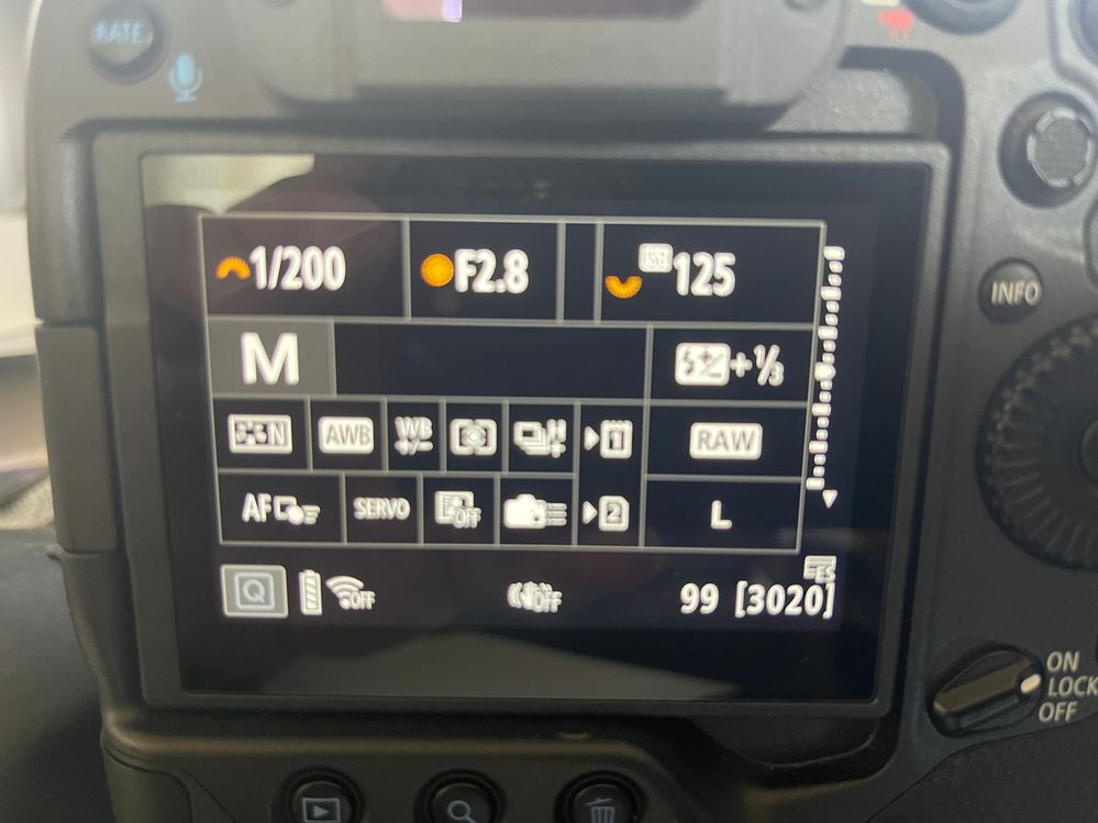

I was on a shoot with my R3 and on the display, the square with the Q is grayed out, as opposed to white when normally working. The Q-button, Menu-button, image playback-button, and the rate-button are all unresponsive. I can still BB focus, change camera settings, and even use the info button. I can take pictures as well. The rest of the camera works just fine.
I successfully updated the firmware (not sure why I was able to access the menus that one time), but after the update the same buttons are unresponsive. I've tried the following:
I brought it to my local camera store and none of the Canon experts have ever experienced this. They also tried everything to no avail.
Obviously I can't access the menus to try to reset the camera. Anyone have any experience with this and how to fix before I send it off?

I notice that your lock lever is set to on. Try turning it off.
07-16-2023 04:16 PM
The power switch on the R3 is like the 1 series DSLR, lock is the center position allowing chosen controls to be locked to avoid accidental changes while shooting. His switch is in the normal on position so the controls are unlocked.

I am told that your switch is in the correct position.
The only other thing I can think of is to remove the lens and see if your missing functions return without a lens installed, on the remote possibility that the lens is causing an issue.

This is an interesting problem. Not one I've seen before. I would not have attempted to flash the camera's firmware as a possible solution. The multi-function lock does allow you to disable touchscreen control, so he might try turning the switch to the off position and power cycling the camera. I doubt it will help, but there is nothing to lose.
To me, this appear to be a "Quick Controls" issue, but if you cannot get to the menu to reset, this cannot be confirmed. I believe the orange menu options indicate these settings are activated. I've not tested this myself. I'm sure Rodger has more experience with them. Canon might be the only one to resolve this.

I did that several times. Nothing.
07-18-2023 04:53 PM
The camera is not locked. I tested that as well. When set to lock, it functions as it should. The issue is centered around the Q menu.
07-18-2023 04:57 PM
I am not sure why the quick control customization would change without me actually going into them in the first place. I have shot on Canons for over 10 years and never came across this. I am hoping there is a way to reset the camera using button combinations rather than only going in through the menus.
