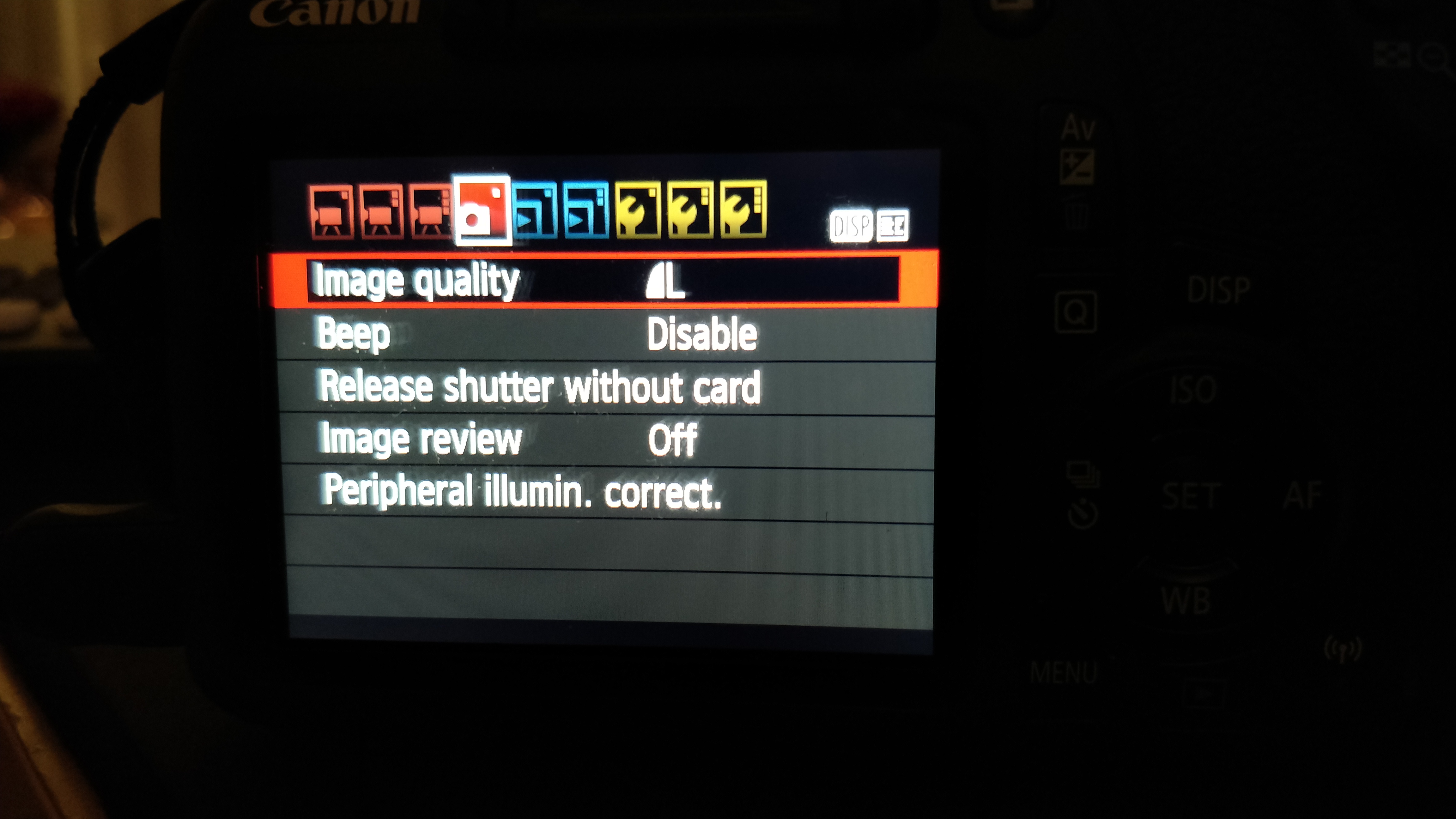

Finally i found the solution!!!!!!!!!!
I got a remote shutter and i block the manual shutter button in the half.
I set the shutter/AE lock button from menu to: AE/AF, no AE lock.
The remote shutter did not need, in this way, batteries.
The display view in the button the expose settings, that i crop it in finnaly output to output 16:9.
In this way i bypass the 30' limit to hdmi ouptut.
ps The remote shutter its not the canon official.
I bought it ~30e.
