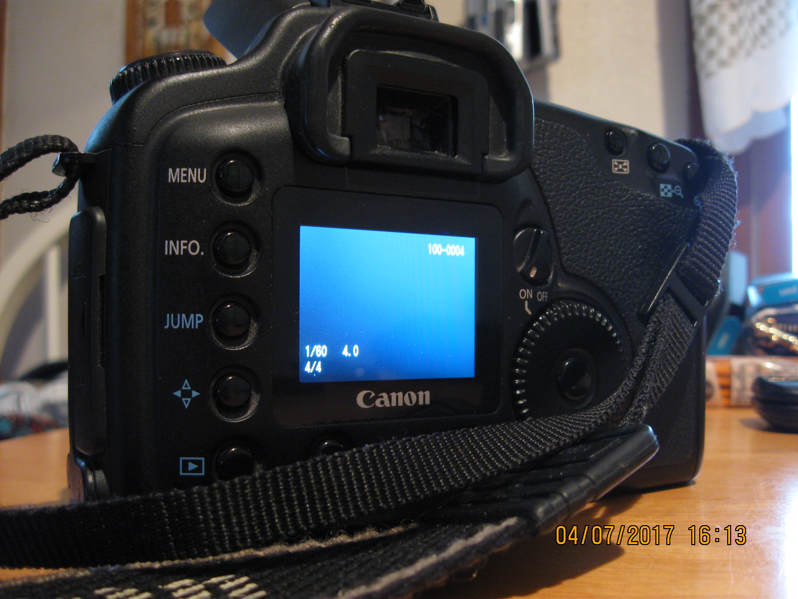

Auto focus won't lock only shoots in manual or bright light in auto. New battery and CF card. No image on display dark screen with only the picture info (shot#,exposure ) playback says no image.
Solved! Go to Solution.

I would certainly try the hard reset but when that doesn't work, I believe your ole 10D has given up the ghost. Not a candidate for repair either.

Have you tried a "hard reset"? you remove the battery & the clock battery (which I assume it had from my 20D ownership) & leave them out overnight to kill any built in memory problems. Any & all settings will be errased by this procedure.

I'll try it thanks! Leave the CF card in or take that out too?

I don't think it matters but might as well remove it.

Hard reset no luck. Ghost is gone.....
