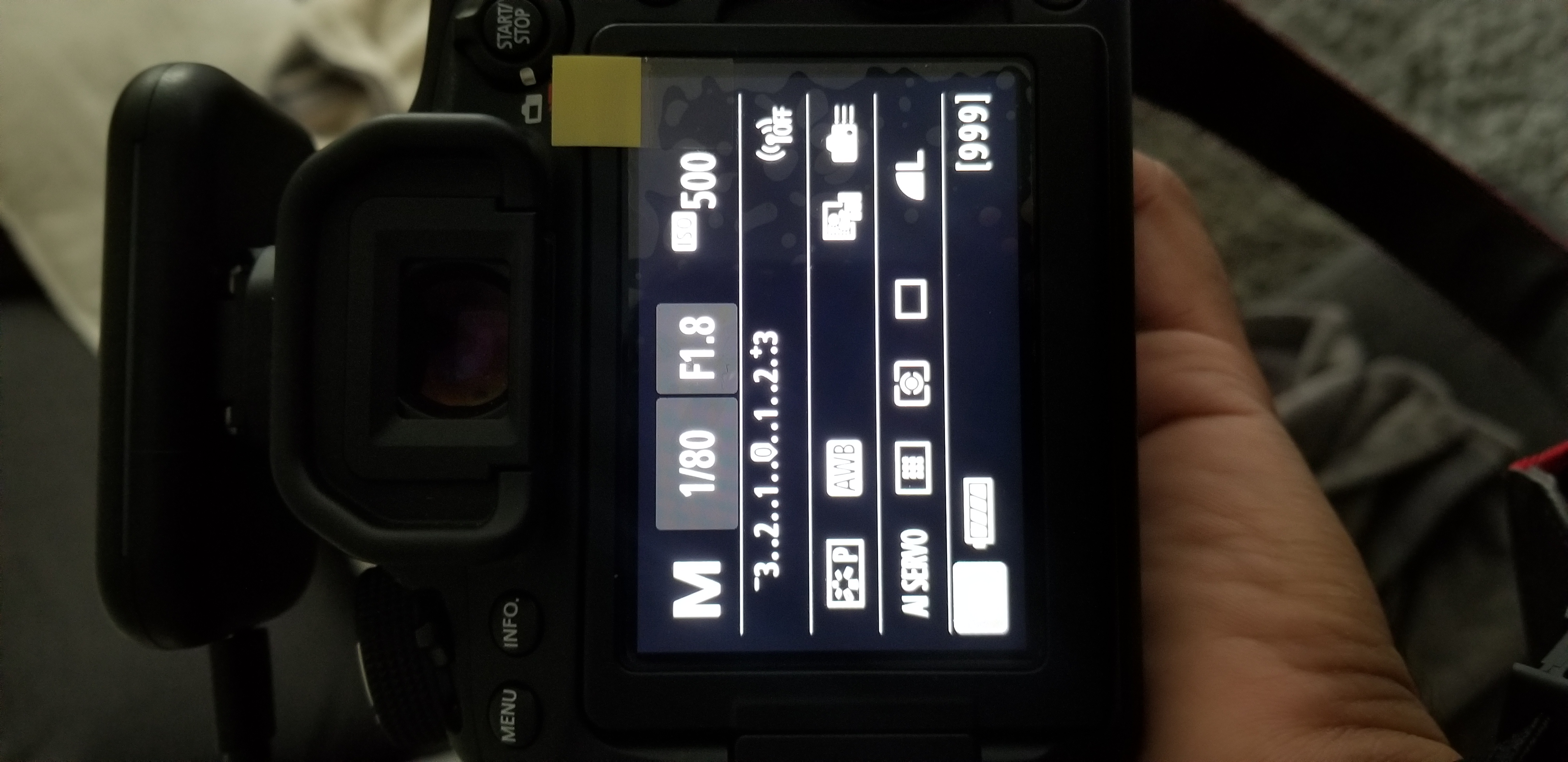

So I was taking pictures last night and I turned off the camera and then turned it on again to take more and all of a sudden the squares won't go red anymore to focus. I tried on AV and manual and the squares just won't focus any more.. Anyone know how I can fix it. These are the settings

It looks pretty dark and dim in that room. The camera may not have enough light for the AF system to lock on a subject. Take the camera to well lit location and try it again. Shooting outdoors on a sunny day would be ideal.
If it dos not work on a sunny day, then you probably have an issue with the camera. Try to reset the camera back to factory defaults. If a Reset does not cure it, contact Canon Support.

Before you dismiss Waddizzle's point, remember that no camera has a dynamic range as great as that of the human eye. It may be that the camera has a better sense of how dim the room is than you do.

The red square is not going to be displayed in AI Servo mode. You need to be in the regular mode.

@diverhank wrote:The red square is not going to be displayed in AI Servo mode. You need to be in the regular mode.
Good catch!

I tried also in one shot mode and still couldn't get focus to work. I'll try to do the factory reset
Why don’t you take the camera to well lit location? While you are it, remove that thing from the flash shoe. Something is definitely wrong becase both shutter speed and aperture seem to be highlighted at the same time.
