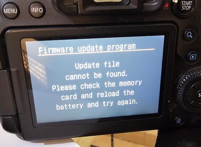

Greetings,
No problem. I am very sorry your update didn't complete. Normally its a simple process that completes in a few minutes.
Last attempt. Remove all accessories form the camera. (Example) Lens, grip, etc. Remove the card and battery. Press and hold the shutter button for 20 sec. Replace (insert) only the battery. Power on the camera. If it goes straight to the firmware update (progress), the FW is corrupt, and it will need to be repaired.
02-01-2024 12:46 AM
"I have followed the advice given. What should I do next?"
02-01-2024 02:00 AM
Press the menu button and see if the main menus return. I suspect they won't but this would be a final effort to recover the camera. All signs point to an incomplete FW flash.
