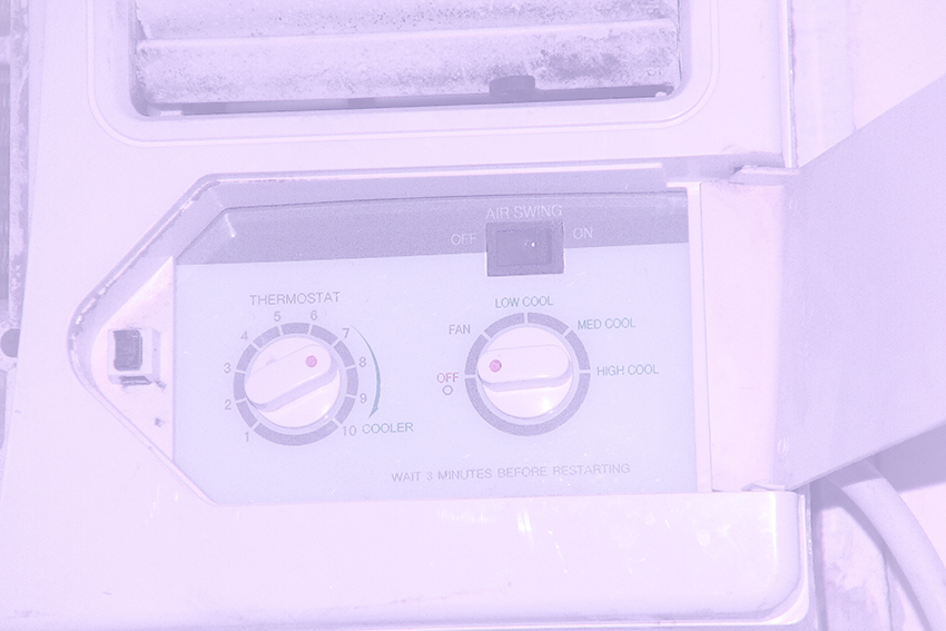

Everytime i took photos on my canon 600d white fill always appear, i tried resetting everyting and changing everything but no to avail success, googling also i tried but no sucess any ideas?

Here's your EXIF data:
Looks like you used manual exposure
Tv (Shutter Speed): 1/100
Av (Aperture Value): 5.6
Exposure Compensation: 0
ISO Speed: 3200
Looks like you cranked up the ISO to 3200. You are heavily over-exposing the shot.
For what it's worth... I very much doubt Ernie was being sarcastic. We get people all the time who aren't sure why they are having a problem with their camera. Usually if they provide a sample shot WITH all the EXIF (meta-data) included, we can often figure out what happened. In your case, your upload did include the exposure meta-data.
The good news is there's nothing wrong with your camera ... it did what you told you told it to do.

Thanks guys for your support, this is the latest image that i've taken from the cam, i did the advise you have mentioned, and produced the same result

You are still using manual exposure at ISO 3200.
Put your mode control dial at full auto (green square) and try again.
10-16-2017 07:24 AM
...although the purple shouldn't be there (that is concerning). There can be a few reasons for it, but they mostly suggest that the file on the card is corrupt. Why it's corrupt is another question... is the card ok (I'd reformat the card or try a different card) or is the camera itself having a problem (there is no camera setting that would ever result in a shot coming out purple like that.) So unless you did something very strange with the lighting in the room, I'd be worried about that.
I would do as Ray suggested... turn the mode dial to full Automatic mode (the green box with the "A+" in it) and take a shot. In that mode the camera will choose all settings and will try to take shot using reasonably safe settings. This is not to suggest you should always shoot in that mode (I never use that mode) -- but it's a good way to test the camera to make sure something you set isn't causing the problem.
I would also re-format your memory card using the "low level" option enabled.
