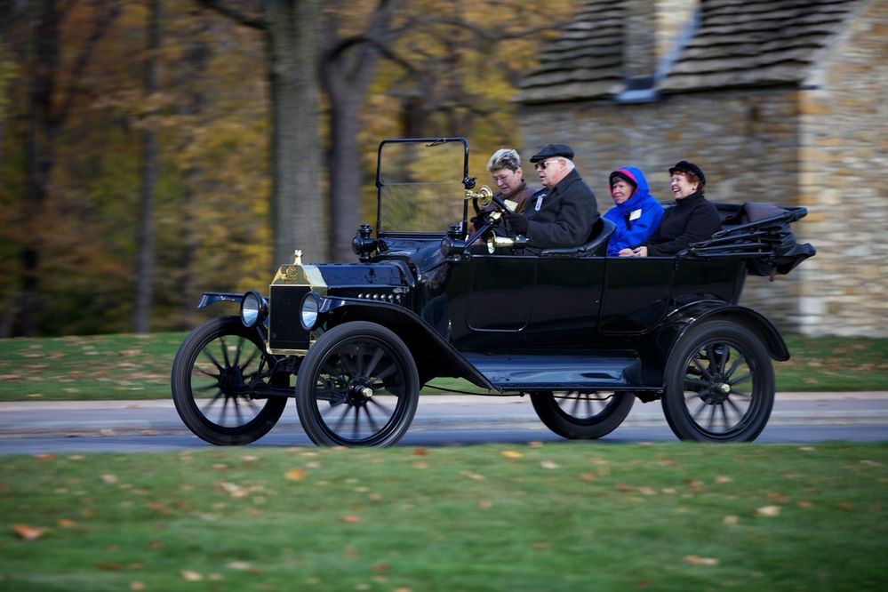

Here are two examples I took:
Joyride
http://www.flickr.com/photos/thevirtualtim/6290685372/
And just in case that one wasn't obvious, here's a more obvious panning shot:
Cyclist
http://www.flickr.com/photos/thevirtualtim/8981989420/lightbox/
In the first image, the car isn't moving that fast, but I'm using a 1/50th second exposure and rather than holding the camera steady, the camera is "panning" to follow the car... giving a reasonably sharp image of a car (except fo the wheels) and rendering the background blurry.
In the 2nd image, the cyclist is actually moving faster than the car was -- and I'm going even a bit slower on the shutter at only 1/40th sec.
Panning takes some practice to be smooth and steady as you follow the subject.  It's probably best to practice during the day... start with a fast shutter and gradually just keep slowing the shutter speed.   With practice you should be able to get a "sharp" subject with a blurred background for a nice "motion" effect in your images.
