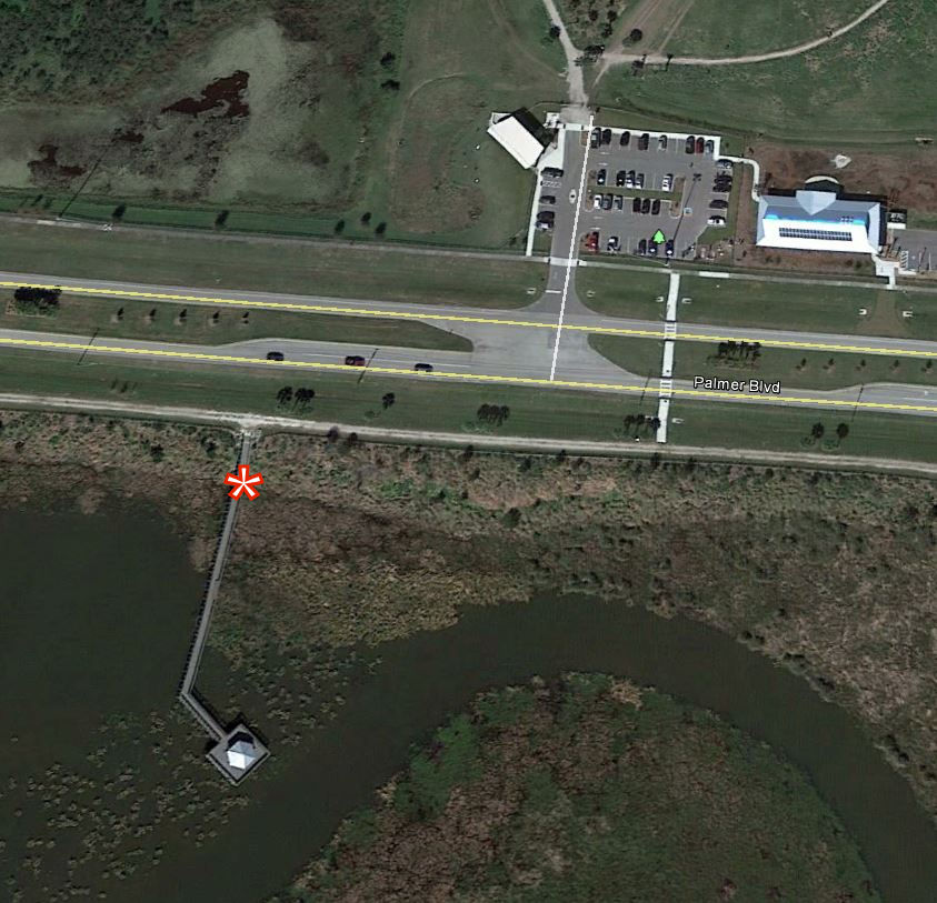

Lance, you don't have to be able to hike for miles to get good bird photos especially living in South West Florida.
This photo
Was taken from a boardwalk (see red asterisk) right across from the parking lot at Celery Fields, 6893 Palmer Blvd, Sarasota, FL 34240
