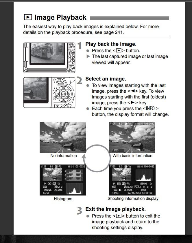

So yoiu see the image right after the shutter fires but not later on when you press the blue arrow key?

That is correct. I have the manual, BTW, and I did look at the above page.

As a test move the mode dial to "P" (Program) Mode to see if the LCD screen works. You can read up in the manual about Live View on Page 106. I provided the link for manual in my post. Canon has the manual on the website free of charge.Screenshot 2023-05-08 195533.png
05-08-2023 08:09 PM
Thanks for the suggestion. I will have to go off line for awhile now, but I will try this tonight.
05-08-2023 08:55 PM
I checked the screen, as you suggested, after changing the mode to P. And I still have the problem. No viewing of photos. Too bad. (BTW, I still have the hard copy of my manual. I don't throw stuff away!!)
