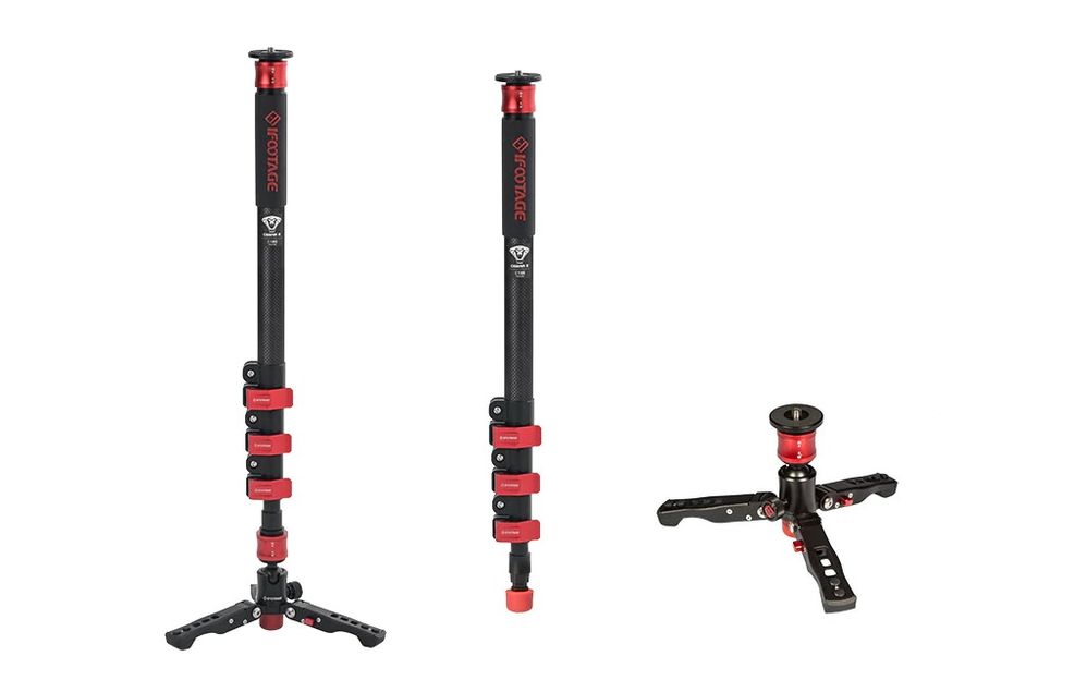

If you do want a compact and efficient camera support, there is one unit that I got recently that is actually a sort of combo of both tripod and monopod, without the disadvantages of the widely splayed legs of a conventional tripod.  It's the iFootage Cobra 2.  You can see from the image below that it gives you three support configurations: a tripod, monopod and mini tripod.  The units clip and switch options very quickly and there is a special ball-head connection at the foot in tripod mode, so you can adjust the tension on the tripod for fast or slow movement as it pivots.  They are actually designed for video work, but that makes them very suitable for wildlife photography.
You have to get your own head to connect the hole in the base of your camera to the top of the unit - I got a SmallRig Aluminum Panoramic Ball Head 3034 for mine and it works fine.
