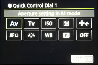

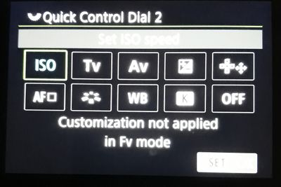

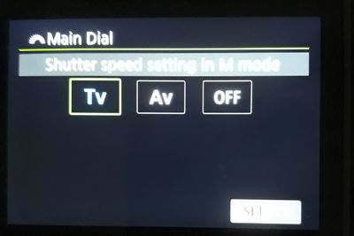

01-22-2026 09:25 PM
I really don't understand what you are after other than being able to have multiple dial configurations, one for each Custom mode. As mentioned, I abandoned manual mode when I went from film to digital some 20+ years ago. Modern cameras are pretty good at picking up a leg of the triangle, especially the R5 series.
Now, I fooled with the dials on my R5 II this evening and with the exception of the limited options of the main dial (see attached image), you can assign a function, register it and other settings to a Custom control (C1, 2, 3), then give the dial another function and assign it to another Custom control. So, in effect, one dial can serve as three different functions plus whatever you have set for the non-function settings. There may not be enough options for what you are trying to do, unlike the buttons, which are almost limitless.
Some crappy shots with my phone, but you can see, unlike the buttons, dials are limited in options.
