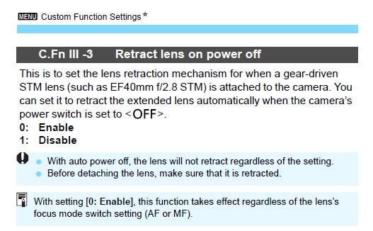

Additionally, The 80D, and most other newer cameras, have a custom function for retracting the lens barrel on a lens after the power is switched off.
