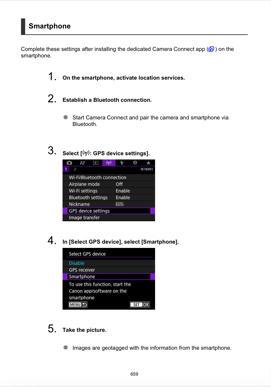

Did you setup the GPS Device as being your smartphone?
2 REPLIES 2
Waddizzle
Thanks Waddizle, that was it
For bot M50 and RP
