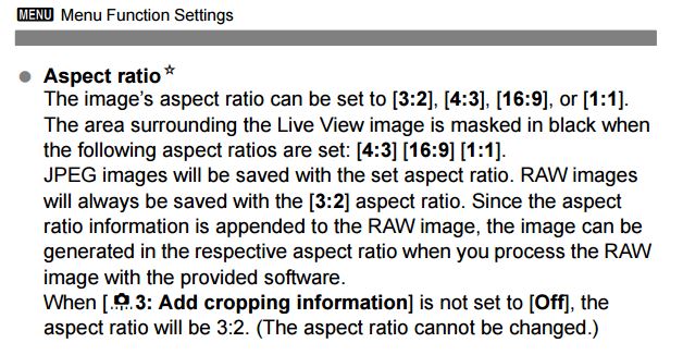

@brandonallen962 wrote:Hey I was just wondering, when I take photos in Live View mode on my Canon 5d Mark III there are brackets that are always on the outside of the image, even when I import them to lightroom and I was wondering how I could turn them off because I've looked everywhere in the settings and can't find anything. Thanks!
There are a couple of settings for Live View that could have presented in what you're seeing:
1. You have the grid display enabled
2. You have set an aspect ration that requires cropping...
I think it's the # 2 if the "brackets" are outside the images. Here is the excerpts of the manual that talks about it:
