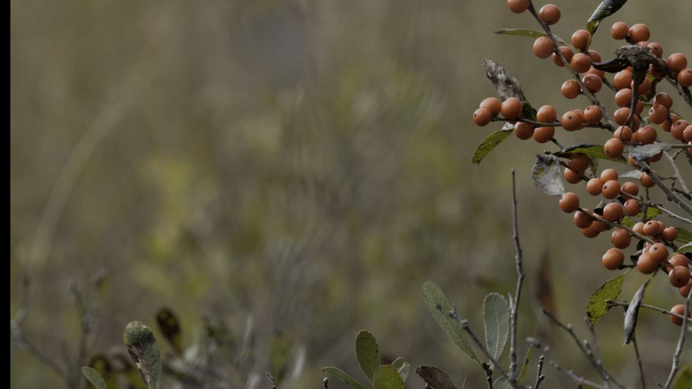

I know this is a bit of an old thread but I have had a similar issue with this lens and combination. Do you think there is a problem in the lens or is this just how it is? Take a look at the branches and Bokeh in these two shots:
12-10-2021 11:32 AM
How are you post processing?
12-10-2021 11:43 AM
This is a grab from Davinci resolve. No processing done. Looking over the images it really appears to be only occurring with the 100-500 lens. Thanks for looking.

It appears to be Nisen bokeh (double-line bokeh) which occurs with many lenses, mostly reported with telephotos across most manufacturers. Google it and you can find more information.
It is believed two of the root causes are a result of correction in the spherical aberration as well as environmental components (busy background/foreground with small, bright highlights as well as high contrast). You may also want to Google Resolving Nisen bokeh for some tips and environments that result in Nisen bokeh. I recently had a similar experience photographing in the jungle with high bright skies and wooded backgrounds.
