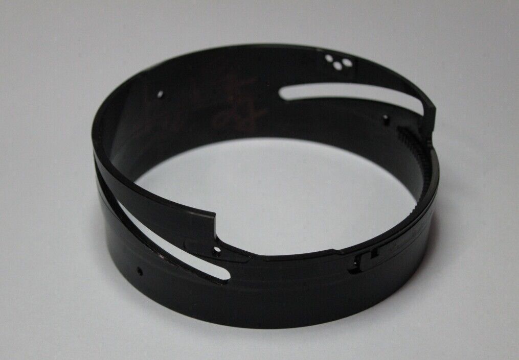

Hi everyone,
I have a canon 60D + 50 mm 1.4 canon lens.
I bought two of them ; but the focus of the lens ( Auto&manual) was not working because of barrel ring deformation.
So, I purchased the part from internet, manual focus works now perfectly. But, the autofocus does not give perfect results. If I zoom while autofocusing, the camera skip the perfect focus and stop focus on a blurry image.
So, what do you think ? could the problem be from the ring or the motor of the lens? and of course, I hope it's not a camera problem...
Thank you very much !

06-30-2017 07:51 AM - edited 06-30-2017 08:10 AM
No, you cannot calibrate the lens up to factory standard by yourself. Even the slightest adjustment of the screws on the helicoid will change the tilting angle of the glass elements of the lens. Improper installation will as well cause trouble.Check if you have over-tightened some screws.
I am a big fan of DIY repair. I found it not so hard to replace parts in cameras.But for lenses, it is a lot more complicated especially when you have to go beyond touching the USM and helicoid etc.
REPAIRING LENS IS NOT JUST ABOUT REMOVING SCREWS AND REPLACING PARTS.
Send it to Canon or use it as manual focus lens and focus in LV.
Good luck to you.
