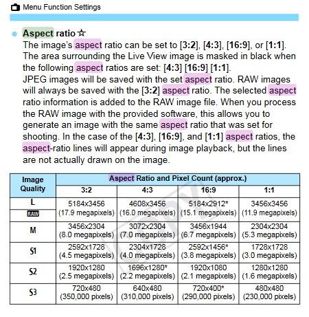

Hi there,
I've got a Canon Rebel SL1. It's my first proper camera, and I got it second hand from a friend.
I've gone into the menu settings to change the aspect ratio of the pictures (to 4:3), but no matter what I change it to, it always takes pictures in a ratio of 3:2. I've looked all over for a solution, but haven't had any luck, so I thought I would try this forum.
Is there something I'm missing?
Thanks in advanced!

Also, see the star next to the heading in the manual? That means you have to be in one of the advanced modes, PAS or M.

If you haven't already, download a copy of the SL1 user manual and spend some "quality time" with it. I think you'll find the camera is capable of doing maybe 10 times as much as you're expecting. Especially if this your first proper camera.
http://gdlp01.c-wss.com/gds/5/0300010915/01/eos-rebelsl1-100d-im-en.pdf
Read the manual a section at a time till you start to get a feel for the camera's controls. If you try to learn it all in one sitting you'll likely feel a bit overwhelmed.
At a glance it looks like different camera settings (shooting mode, saving RAW images, using Live View, etc.) may have some effect on the available aspect ratios.

It should be working. What is the image size you do get? Try setting it to L and see if that helps.
01-10-2020 07:15 PM
I went through each of the picture size settings. If I take a picture through the viewfinder, they come out at 3:2, no matter what size I've selected in the settings. If I take a picture through the video screen, the pictures are whatever size I have selected in the menu. I can switch back and forth, from picture to picture, and this is always the result. Absolutely baffling.
