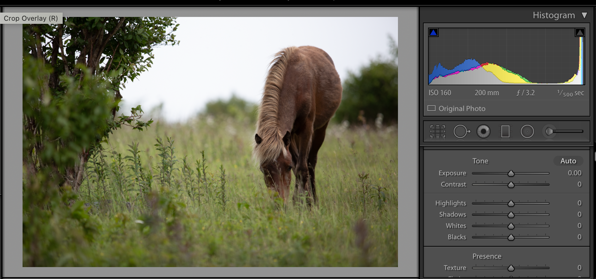

Here is another blurry image. I included the ISO, focal length, aperture, and shutter speed (shown at right). I focused on the eye. She was not moving aside from chewing. It took me about ten frames to get her in focus.
I was able to get her sharp here, again, after quite a few shots (final edited photo):
Thanks!

Before youcall Canon reset all camera settings and custom functions and then try again.
The behavior you are describing does not sound normal at all.
