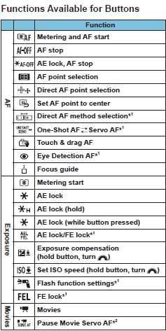

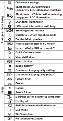

I cant seem to set a button to adjust the Kelvin of the White Balance. I am able to scroll across the different White Balance modes (AWB, Daylight, Shade, Cloudy, ect...) and although I can select the Kelvin setting, I am unable to change the variable itself. I know I can go to the menu, go to page 4 of camera settings, select white balance, scroll to Kelvin setting, and then adjust the variable but on my 60D I was able to change it with a single button. Anyone have a solution?
I'd really appreciate the help, I'm currently using AWB but would absolutely prefer to set it myself.
Thanks!
01-25-2019 08:42 AM - edited 01-25-2019 08:59 AM
On my 5D Mk III there is a button on the top for WB but not on my 80D.
On the 60D. I do see that the "SET" button can be customized for WB selection.
The EOS R has customizable controls, but I don't see one for White Balance.
