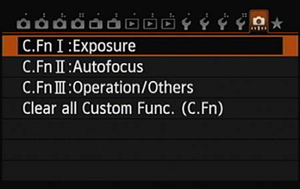

Besides clearing all settings, which is misleading I know because it doesn't, you need to go here...........
The Custom Functions menu on your 70D, which is available only when the Mode dial is set to P, Tv, Av, M, B, or C, you will see some submenus. One is "Clear all custom functions", you need to do that in addition.
