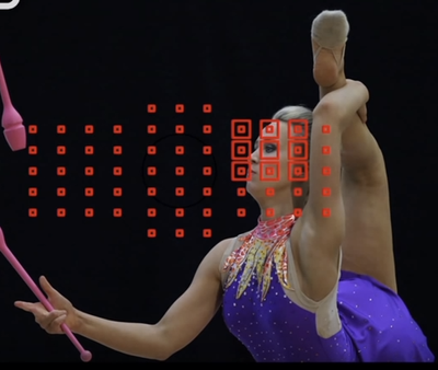

Assume I select "AF Center Point: Surround" as in the example below [1]:
My question is on the following scenario:
1) I am in AI Servo mode
2) I have acquied the subject correctly (as above)
3) I am using back-button AF to "hold" the lock on the subject as she moves.
4) She is moving moving quickly to our left, a little faster than I am panning.
5) She ends up under the far left focal points.
Given the above, will the AF switching use all the AF points beyond the 9 I selected to keep her in focus?  Or does it only pass AF points among the 9 I chose in Surround mode and I have to keep those 9 "covering" her as she moves in order to stay in focus?

The short answer is no...if she moves off the 9 points you'd lose AF.   You would have to pan after your subject.  It would work if you activate all 61 points but then you don't really have control over which point the focus should be at.
