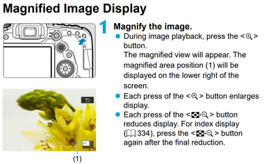

When trying to view images on the screen on the back of my 90D, my camera constantly wants to zoom in on the image, and there's no way to stop it. A real nuisance. I've either hit a button somewhere that caused this, or there is a malfunction somewhere. Anyone else ever have this problem? My 80D isn't doing this, so something has happened.

Hi and welcome to the forum:
If you have hit the +magnification icon at some stage and not reversed that by using the -magnifying icon, then it will default to that when you next open up the view function next time. I have checked the manual and cannot find any other reference to magnifying an image when viewing.
