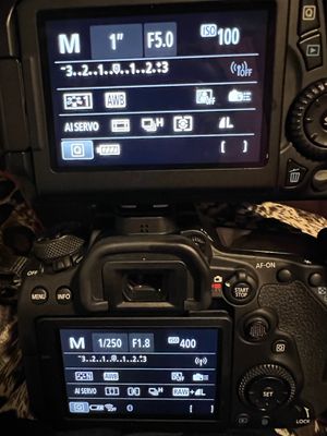

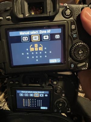

Thank you. Really appreciate your time.  I guess I’ll have to do with those lines 🤪
for the focus, I just have my 70D and and my 90D in almost exact same modes, with manual focus point.
and on my 70D I can play with the round button on the side of the LCD and change my point of focus accordingly, 90D is lovked in the area I preselected. 😞
this issue really won’t do for me. It’s a terrible change that doesn’t allow me to take pictures in a flowing way.
(in pictures the 70D is the top camera)

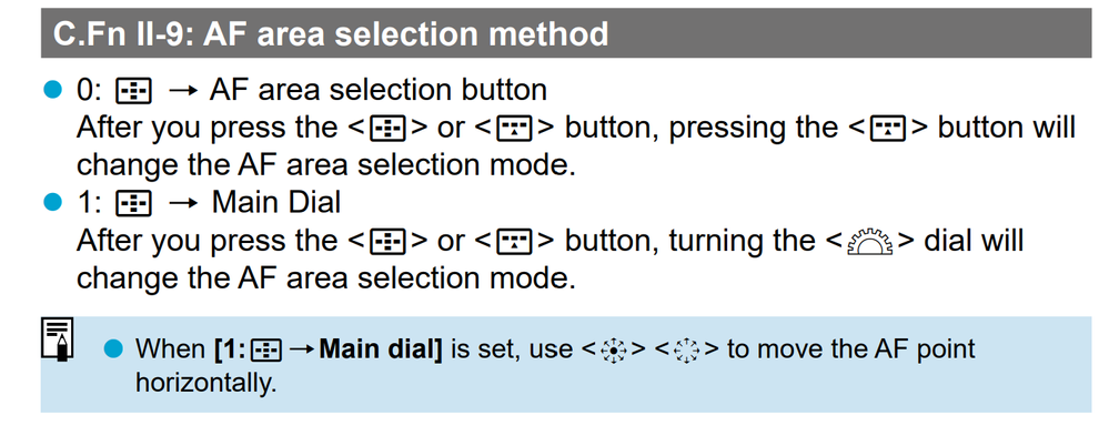

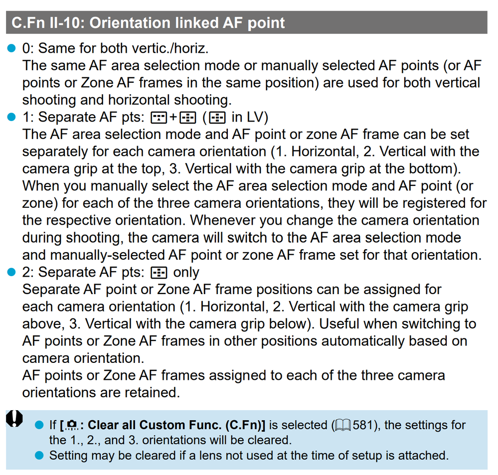

The main dial (the one behind the shutter button) can be setup to change focus zones If configured in the Custom Functions Menu. The joystick by default isn't configured to change AF points. Screenshot 2023-03-23 175555.pngScreenshot 2023-06-03 211229.png
