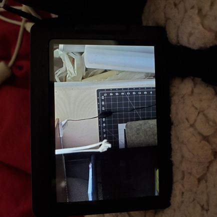

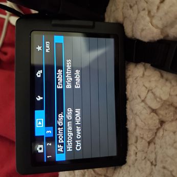

I just received my new to me 77d. I do have af points display enabled. Yet, the af points are not showing up in playback.....I only seem to see the SF points displayed when I use AUTO mode. However, I use P or Av most of the time...and the af points don't show up.

I see the af point when I am taking photos...its when I am in PLAYBACK mode that I dont see the AF points displayed.

Hi, so I went ahead and cleared settings. Its now showing the AF Points in Playback. YAY!
