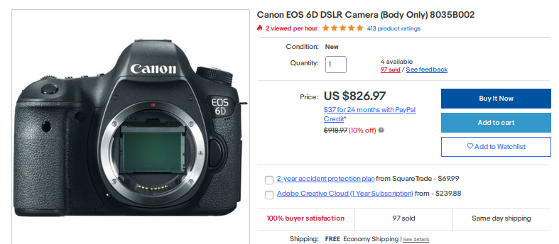

12-19-2020 05:03 PM
Or you can use your $250 + whatever Canon may charge you towards a brand new 6D (not Mark II) on ebay :
12-20-2020 10:06 AM
"... a brand new 6D (not Mark II) on ebay :"
I can't imagine someone going backwards to a 6D (much less a camera than the Mk II) after owning and using a Mk II.

12-20-2020 09:34 AM - edited 12-20-2020 09:39 AM
@addhu,
My advice.
If you want the camera fixed and operational, send it to Canon. As Ernie (ebiggs1) would say, "This is not a DIY project'. You can do what you want, but if you want it repaired... >>> Canon. You have no idea what's going on in the camera or what it will take to fix it. You want to guess, go for it. When your in for several hundred dollars + your time and were lucky enough to get it back together without damaging something... and then it still doesn't work, you'll remember this advice.
eBay... Don't do it. (Sorry @SBK) Once again, >> Canon or at the very least B&H. Or maybe you can get something in Singapore, I don't know, but buying from eBay can go really well, or really, really bad. If you like to gamble, then go for it.

"eBay... Don't do it. (Sorry @SBK) Once again, >> Canon or at the very least B&H."
Thank you for the reminder.
Tempted by the eBay prices for a few lenses, but ended up buying an EF 200mm 2.8L from my local Canon authorized dealer.
