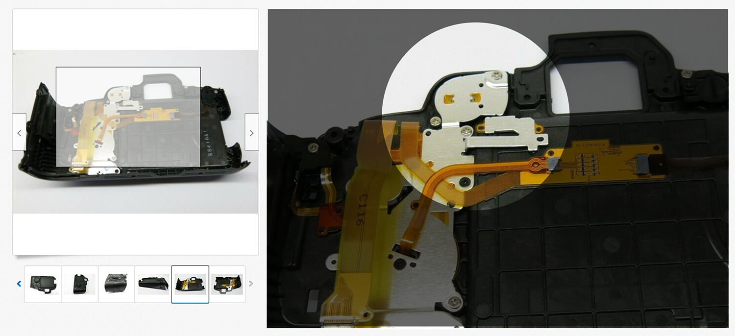

Since the issue is coming only when toggled to Photo mode, what do you think about changing the front shell myself (since it has the toggle assembly and its cables on it)? (Since this doesn't involve the risky disassembly of sensor components)
I'm just fishing for the most economical fix, so I can upgrade the cam after that. No one would buy this in its current state I suppose (at a reasonable price).
This part costs under $100
I have never used a 6D Mark II so I am not familiar with the entire button layout but given the behavior I wouldn't expect the photo/video switch is the issue.  Given the lagging and intermittent response is only in still mode, I suspect that if it is a button/control that is involved it is likely one that is functional only in still photography mode.  The controller may be reading a switch input that is neither open nor closed causing it to hang up on handling that input.  I haven't seen the topology of Canon camera controls but a near universal standard across products is that controls/inputs aren't read continuously but are polled by the controller at high speed; in a system like this a problematic input will slow the entire controller down.  This would be consistent with a switch or control that has leakage from the sustained high humidity storage.
What can happen with cameras and other gear that have oil/salt transfer from human hands is the moisture will allow this to wick into a control's contacts and if it stays moist for a sustained period then conductive corrosive residue will build up.
IF this is the case then it won't be a cheap repair from Canon because they will be replacing a lot since most parts will be entire assemblies and not a single component.  Because your expense to send it in is so high even for an estimate, it is a gamble.  I would be tempted to sell this as parts only/working fine for video rather than paying a lot for just an estimate and probably considerably more for a repair.  It would be a much easier choice if transport to repair was cheaper and then I would definitely let Canon take a look and give you an estimate.
