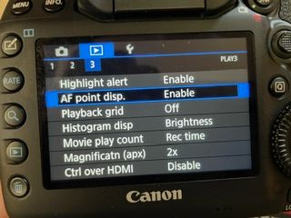

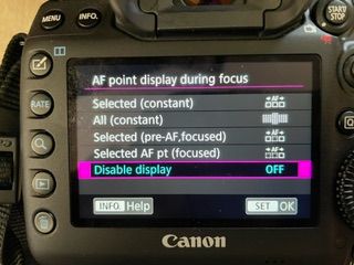

Back to the original question.  I
How do I view the AF points when the camera is in M, AV, TV, or P mode?  As Deebatmat316 correctly notes that page 149 of the manual states: "You CAN set whether to display the AF points . . . after focus is achieved."  But the manual does not describe HOW you can change the setting from Display OFF.  There is no other option to choose.  HELP!Camera in Full Auto modeCamera in Full Auto modeAfter selectng AF point dispAfter selectng AF point dispCamera in P modeCamera in P modeAfter selecting AF point display during focusAfter selecting AF point display during focus
You need to select "All (Constant)" to see the AF Points all the time.
You are conflating apples with oranges.
The “Blue” menus are the “Playback Menu” system.  Those settings determine how images are played back on the rear screen.   They have noting to do with the AF point display in the OVF.
I recommend setting “Magenta” menu you have displayed on the right to the top selection.
Selected (Constant)
[EDIT] That same menu is indicating that you the AF Display disabled.
