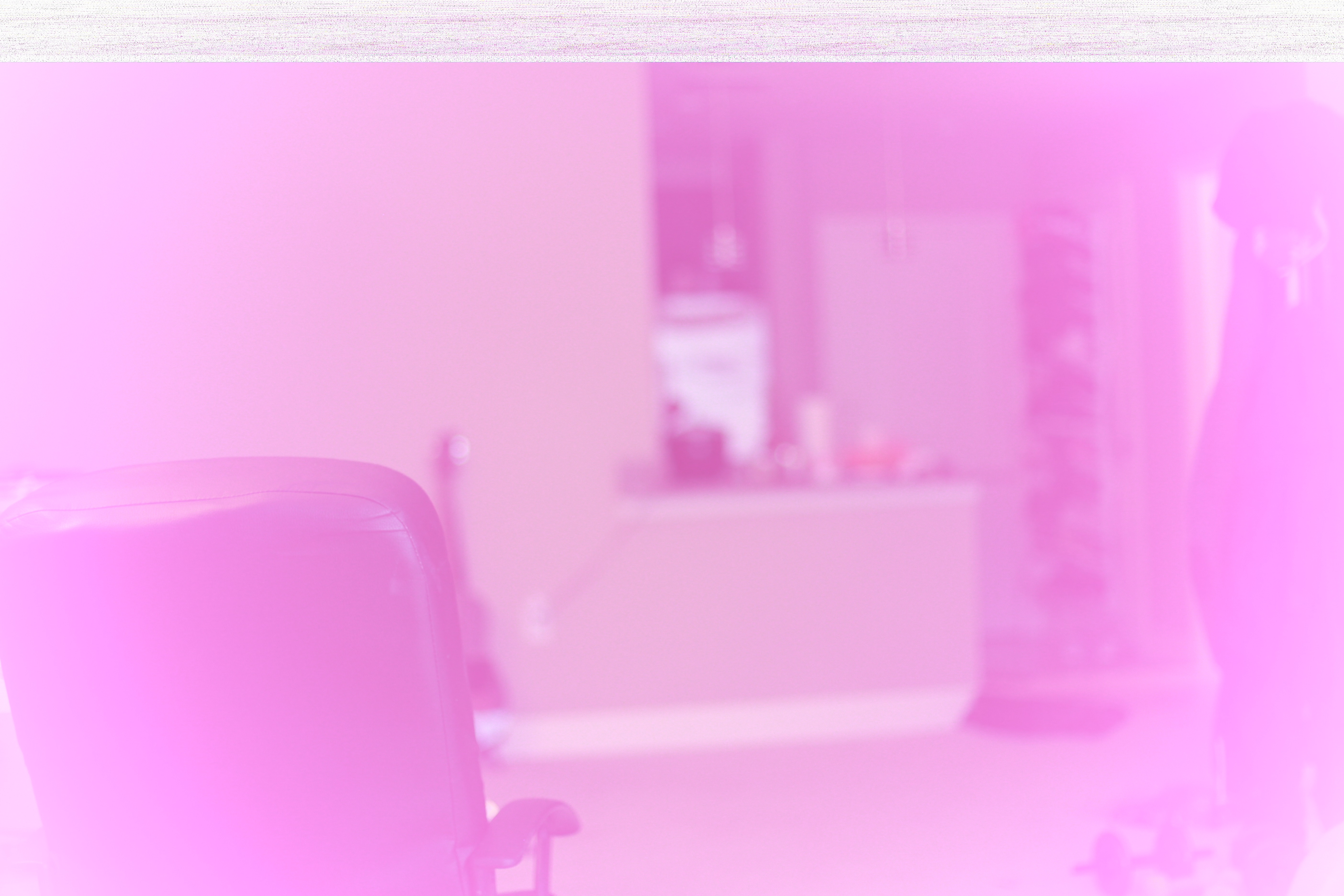

5D mark 2 unknown issue
happyxujin
Orgial picture.
All the picture I took become pink like this.
Does anyone know why ?

Can you provide a bit more detail?  When I check the EXIF data on your original image, it says it was taken with a 5D II on Dec 6 at 12:06.  The "pink" image was taken on the same day at 12:05.  (the non-pink image was actually taken 21 seconds AFTER the pink image.)
Is this something where you import the image onto the computer... it looks fine... and then some time later you try to re-open the image and it's corrupt?
I'm trying to understand the timeline.  For example... you might have a memory card starting to flake out on you if some images are always pink.  But if a single image was ever ok at one moment... and then corrupt (the same image -- not a different image) at some later time, then it suggests that the camera itself is ok and the problem is either with the card or with your computer.
I have actually personally experienced issues like you depict below -- when the hard drive on one of my computers was failing.   The physical read/write heads were no longer properly aligned to the tracks on disk... so each "write" was slightly bleeding data into the adjacent tracks and corrupting data.  The hard drive was wiped, low-level formatted, and restored from backup and verified clean... only to have the proplem reoccur within days (indicating that the read/write heads were actually loose/sloppy and failing to align precisely over the intended track.)  Once that drive was replaced... issues like this never happened again.
But just because the reason some of my own images were corrupt (by a failing hard drive) doesn't mean it's the same cause for your image.  I only bring it up because tracking down the culprit will require a bit more info.   We need to understand your "workflow" and timeline.

Sorry, I posted in a hurry without detailes.
So actually there are 4 photoes I took on Dec.2013. The first 3 are pink and one is normal(Last one).
I turned on my camera, random shoot a photo.--> pink
I turned it off and turned again--> pink again.
I turned it off and turned again--> normal
The pink pictures are almost same. Only difference I can tell is the top of each image. ( it is like noise or something)
First one.
Second one.
Third one.
I don`t think my computer has a problem because I check my camera after the shot.
Pictures turned into pink on the camera after the shot. So we can elimite softeare issue or computers
Also, this is not happen every time. Sometimes, it just work fine. So I can`t find any kind of clue when it happen.
Some time it works well....and then suddenly next picture became pink.You restarted it, it works as normal for certain time( 1 shot, 10 shots,  it varies) .And , pink again.
Restarting the camera may fix this issue for 70% of the time.But sometimes it remain the same no matter how many times you restart the it.
I thought my CF card could be a prolem. So I swaped my CF card with my girlfriend(she has a 40D). But this pink thing still happen.
My CF card: Transcend Compact Flash 400X UDMA7 32GB
Filesystem: FAT32
Let me know if there is any othere details I can provide and how do you think.
Feel free to provide any way for troubleshooting.
More pictures provided.
12/16/2013 11:35 AM
12:04 PM   A normal image after several restart.
12:04PM-----------------------> Pink again ------ on the top of picture
12:04 PM
