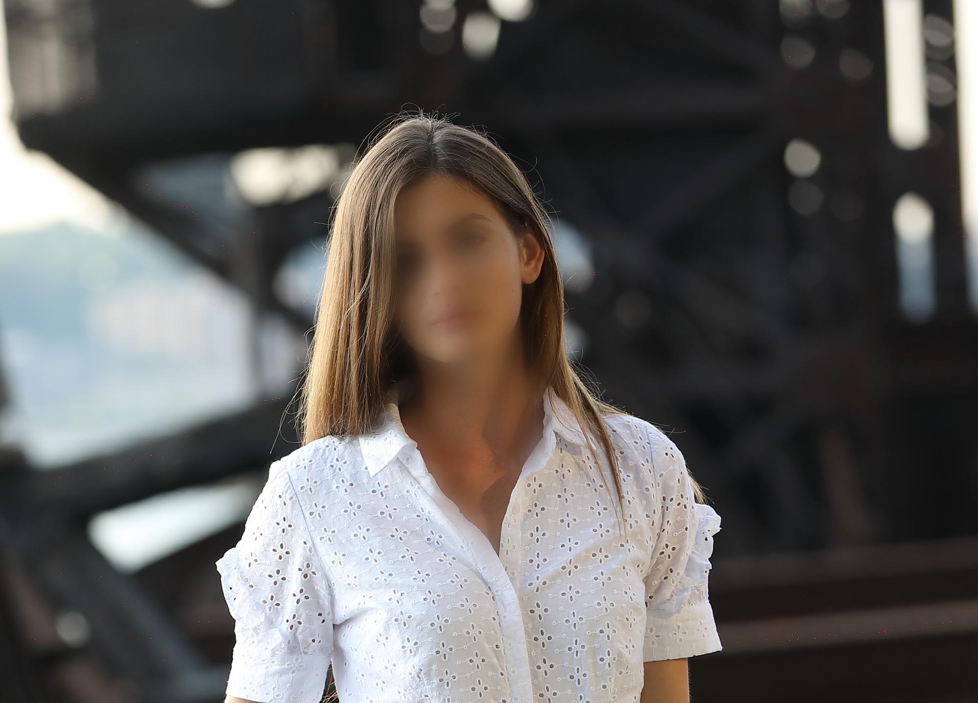

Thanks Peter,
Using Adobe Raw is definitely a servicaeable workaround. Shame that DPP doesn't remove hot pixels but perhaps they can add to future version. Appreciate all of the support of the Canon Community. I've attached a photo illustrating my hot pixel situation.
Phil
07-06-2020 09:26 PM - edited 07-06-2020 09:41 PM
That is much worse than I expected and perhaps something else than hot pixels. All red and with the same intense even in full daylight. No red dot in dark area or bright area. Do you have a raw sample? Easier to check the pixels before . Two raw files taken in daylight and another one with lens cap on with the same shutter speed. Use a filehost like Google Drive or Dropbox.

07-07-2020 02:32 AM - edited 07-07-2020 03:06 AM
The red pixels move around. Some of the red pixels have a green hot pixel beside them but the red is alwas the strongest. You have no red pixels in your last frame, the black one. I would say that they are not the classic hot pixels but the way to remove them in post works. Both darktable and RawTherapee are able to remove them and so does Adobe Camera Raw as you wrote.
Call Canon for a repair because this is not normal for any camera model from Canon.
