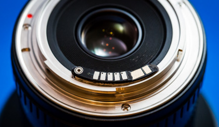

Is there focus confirmation chip on the mount ?
If negative, no focus confirmation.(top pic)
You may add EMF confirmation chip to achieve the result. (bottom pic)

"I read, that focus confirmation is notworking with third party lenses"
The confirmation is done by the lens talking to the camera. It isn't the camera's fault if the lens can not 'talk'.
11-01-2017 10:27 AM
BTW, the Samyang 50mm f/1.4 AS UMC Lens has no electronic coupling with the camera. Canon will never give focus confirmation in the viewfinder because of no electrical contacts. Use live view to ensure accurate focus.

I will mention EMF confirmation chips are not with out issues of their own either. They have to be installed correctly (glued on!) and programed to a fixed focal ratio.
