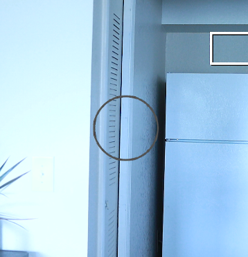

Hello everyone!, i'm new here but i'll make this as simple as possible.
Has anyone had luck with any workaround for the auto shutoff "tax" feature in their EOS cameras?.
I've been looking everywhere for anything to help avert this issue as i originally bought my T7 to operate as my primary camera for streaming.
I know a lot of you will say "This is not a web camera" and such, however there is no reason not to try to improve quality for a persons content.
Magic Lantern is not working on anything T7 related so that is off the table. If anyone has ANY idea how to get the camera to last longer than 30 minutes i would LOVE to hear your workaround.

pssst. that picture is proof of clean hdmi on a t7.

I have a solution for you. In order to get a clean HDMI output with a canon T7 or T7i, you must utilize a lens other than the kit lens. For instance, I am using a 30mm with 2.8 aperature. Switch the camera to 'manual focus' and then switch it into 'movie mode'. Switching it into 'manual focus' will remove the white focus box. Switching it into 'movie mode' will remove the black ring (the black ring is associated with the 30mm lens). The camera is connected to an HP laptop via the HDMI cord. The HDMI cord is connected to the Elgato Cam Link, which is connected to the laptop via the USB port. I cannot attest that this works for every camera or lens, however it works for the above configuration.

If you're streaming with a CamLink (way better than EOS software) don't put it in movie mode, you want it in one of the still camera modes. The Camlink is sending the display of the camera, not it's end product, so your still camera will be sending video too. Which camera mode depends on how much control you want, but that's up to you. You gotta use manual focus to remove focus box, and don't forget to disable the regular auto shutoff setting if you haven't already. I'm using a T7 with CamLink.

This is great, except for he white auto fucus box that doesnt seems to go away. Any ideas?
